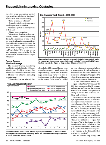

“Most of our dies have at least two
sensors,” he says. “Die crashes are way
down, to a maximum of one or two
per month, a huge improvement from 100 the double-digit monthly die crashes the
firm once endured. “And now when a 50 press stops, everything else stops as
178
127.75
106 121.325
Die-Breakage Track Record—2008-2009
150
138.5 106.75
60.375
42.25 30
75.5
99.625
10 8 11 14
66
134.425
Man Hours Occurances
January February March April May June July August September October November December January February March April May June July August September October November December
Man Hours
well,” says Butler. “Not so long ago we were averaging 40 man-hr./day for die maintenance; that’s now down to just 5 hr./day.”

The domino effect from Clairon Metal’s ongoing improvements is best illustrated by this graph of production efficiency, which has climbed from barely 50 percent in 2006 to near 80 percent today.

Clairon’s in-die sensing program, ramped up since it installed new controls on its 10 hardest-working presses, slashed die-repair costs by 70 percent in 2009, and the firm expects the figure to drop another 80 percent in 2000.
ple and affordable change like new press controls can change everything you do in your facility,” says Butler. “With ton- nage monitoring, we’ve been able to treat any press-overload cases like cor- rective actions. Doing so, we’ve avoided
any ram-adjustment issues and failures in areas such as tie rods and counter- balance rods. We also use the data from the monitors to take a proactive approach to scheduling preventive-maintenance activities, such as tool sharpening.
“In 2008 we spent more than $50,000 to repair broken tools,” Butler adds. “In 2009 that cost dropped by 70 percent, and this year we’ll reduce that expense by another 80 percent. Next year we’re aiming to cut it in half, and we’re con- fident we’ll get there.”
Not content to rest on its impressive 4-plus-year track record of continu- ous improvement, Clairon’s on a mis- sion to keep pushing for more. Among its most recent improvements, says But- ler: “We’re focusing on streamlining our troubleshooting procedures at the press. When a die-maintenance tech- nician goes out to a press to address a problem, he’s now got 30 min. to decide whether to pull the tool or repair it in the press. We’ve developed specific guidelines for them to follow so that they make those decisions more quick- ly and, in the end, make sure our press- es are running at the highest level of productivity possible.”
And the dominos keep falling...MF www.metalformingmagazine.com
