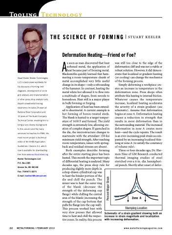

Simply deforming a workpiece cre- ates an increase in temperature in the deformation zone. Press shops often attribute this heating to internal friction. Whatever causes the temperature increase, localized heating accelerates the severity of a strain gradient (see schematic). Assume that deformation begins at zone A. Deformation heating causes a reduction in strength that results in more deformation than in the surrounding material. The increased deformation in zone A creates more heat—and the cycle repeats. The result is an ever-increasing peak strain accom- panied by an increasing localized thin- ning at zone A (to satisfy the constancy of volume rule).

Schematic of a strain gradient showing both an increase in strain magnitude and localization with increasing deformation.
Percent Major Strain
   22   23   24   25   26
