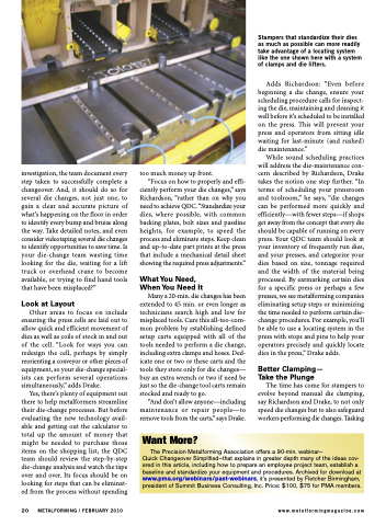

Stampers that standardize their dies as much as possible can more readily take advantage of a locating system like the one shown here with a system of clamps and die lifters.
Adds Richardson: “Even before beginning a die change, ensure your scheduling procedure calls for inspect- ing the die, maintaining and cleaning it well before it’s scheduled to be installed on the press. This will prevent your press and operators from sitting idle waiting for last-minute (and rushed) die maintenance.”
While sound scheduling practices will address the die-maintenance con- cern described by Richardson, Drake takes the notion one step further. “In terms of scheduling your pressroom and toolroom,” he says, “die changes can be performed more quickly and efficiently—with fewer steps—if shops get away from the concept that every die should be capable of running on every press. Your QDC team should look at your inventory of frequently run dies, and your presses, and categorize your dies based on size, tonnage required and the width of the material being processed. By earmarking certain dies for a specific press or perhaps a few presses, we see metalforming companies eliminating setup steps or minimizing the time needed to perform certain die- change procedures. For example, you’ll be able to use a locating system in the press with stops and pins to help your operators precisely and quickly locate dies in the press,” Drake adds.
