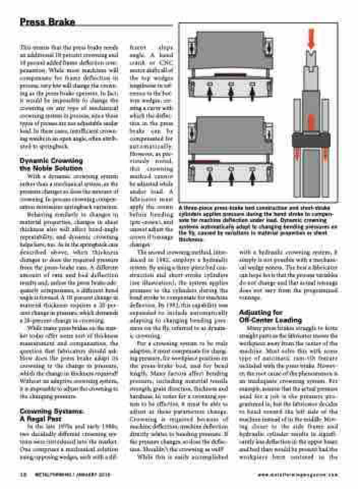

In the late 1970s and early 1980s, two decidedly different crowning sys- tems were introduced into the market. One comprises a mechanical solution using opposing wedges, each with a dif-
ferent slope angle. A hand crank or CNC motor shifts all of the top wedges lengthwise in ref- erence to the bot- tom wedges, cre- ating a curve with which the deflec- tion in the press brake can be compensated for automatically. However, as pre- viously noted, this crowning method cannot be adjusted while under load. A fabricator must apply the crown before bending (pre-crown), and cannot adjust the crown if tonnage changes.
A three-piece press-brake bed construction and short-stroke cylinders applies pressure during the bend stroke to compen- sate for machine deflection under load. Dynamic crowning systems automatically adapt to changing bending pressures on the fly, caused by variations in material properties or sheet thickness.

The second crowning method, intro- duced in 1982, employs a hydraulic system. By using a three-piece bed con- struction and short-stroke cylinders (see illustration), the system applies pressure to the cylinders during the bend stroke to compensate for machine deflection. By 1992, this capability was expanded to include automatically adapting to changing bending pres- sures on the fly, referred to as dynam- ic crowning.
