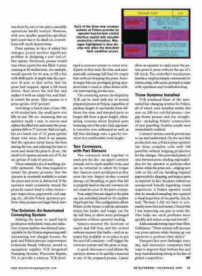

Each of the three new conveyor systems at Polaris provides an operator touchscreen control interface loaded with valuable production information. Mes- sages highlighted in blue dis- play only when the described fault condition occurs.
oped a conveyor system to count actu- al parts as they enter the bins, and auto- matically exchange full bins for empty bins without stopping the press. Sever- al empty bins are prestaged, giving oper- ators time to tend to other duties with- out interrupting production.
