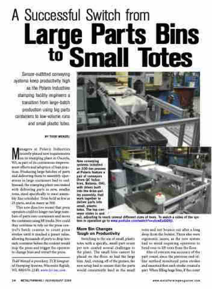

New conveying
systems installed
on 200-ton presses
at Polaris feature a
pair of conveyors
(from QC Indus-
tries, Batavia, OH),
with drives built
into the drive-pul-
ley assembly, that
work together to
deliver parts into
small, plastic
totes. The top con-
veyor slides in and
out, adjusting to reach several different sizes of tools. To watch a video of the sys- tem in operation go to www.youtube.com/watch?v=uIuwEaQQ9jI.
