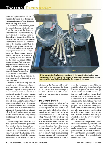

If too many or too few fasteners are staged in the bowl, the feed system may run too quickly or too slowly. The amount of fasteners is controlled by a hopper sensor, which sets the high/low limit for the amount in the bowl.
