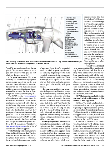

   1. Service crane
2. Generator
3. Cooling system
4. Top control unit
5. Gearbox
6. Main shaft with two bearings
7. Rotor lock system
8. Blade
9. Hub
10. Hub cover
11. Blade bearing
12. Bed frame
13. Hydraulic unit
14. Shock absorbers
15. Yaw ring
16. Brake
17. Tower
18. Yaw gears
19. Transmission–
High-speed shaft
This cutaway illustration from wind-turbine manufacturer Gamesa Corp. shows some of the major fabricated and machined components of a wind turbine.
