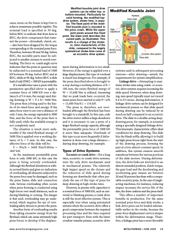

 Modified Knuckle Joint
Slide adjustment
Motion curve, point B
Eccentric drive system Press slide
Flywheel Drive shaft

Modified knuckle-joint drive systems can be either top- or bottom-mounted. Particularly for solid forming, the modified top- drive system, shown here, is popu- lar. The fixed point of the modi- fied knuckle-joint is mounted in the press crown. While the upper joint pivots around this fixed point, the lower joint describes the curved path, as-illustrated. This results in a change of the stroke- vs.-time characteristic of the slide, compared to the largely symmetrical stroke-time curve of an eccentric drive system.
