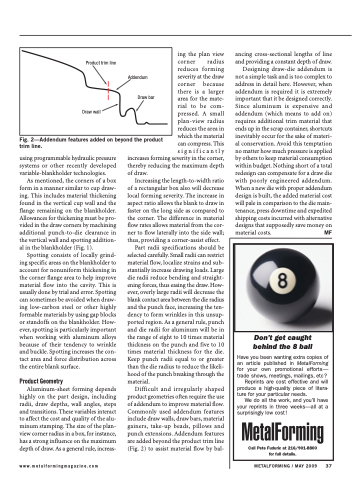

   Product trim line
Draw wall
Addendum
Draw bar
     Fig. 2—Addendum features added on beyond the product trim line.

Difficult and irregularly shaped product geometries often require the use of addendum to improve material flow. Commonly used addendum features include draw walls, draw bars, material gainers, take-up beads, pillows and punch extensions. Addendum features are added beyond the product trim line (Fig. 2) to assist material flow by bal-
