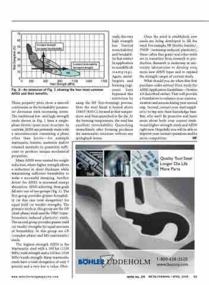

   70
60
50
40
30
20
10
CP
 Constant strength
increased stretchability
 TRIP
DP
MS
Constant stretc
in
creased strength
hability
0 200 500 800 1100 1400 1700
Yield Strength (MPa)
Fig. 2—An extension of Fig. 1 showing the four most common AHSS and their benefits.

These property plots show a smooth continuum as the formability parame- ter decreases with increasing strain. The traditional low- and high-strength steels shown in Fig. 1 have a single- phase ferritic (pure iron) structure. In contrast, AHSS are primarily steels with a microstructure containing a phase other than ferrite—for example martensite, bainite, austenite and/or retained austenite in quantities suffi- cient to produce unique mechanical properties.
Many AHSS were created for weight reduction, where higher strength allows a reduction in sheet thickness while maintaining sufficient formability to make a successful stamping. Another driver for AHSS is increased energy absorption.AHSSachieving thesegoals fall into one of two groups (Fig. 2). The first group provides greater formabili- ty (in this case total elongation) for equal yield (or tensile) strengths. The primary steels in this group are the DP (dual-phase) steels and the TRIP (trans- formation-induced plasticity) steels. The second group provides greater yield (or tensile) strengths for equal amounts of formability. In this group are CP (complex-phase) and MS (martensitic) steels.
The highest-strength AHSS is the Martensitic steel with a 180 ksi (1250 MPa) yield strength and a 220 ksi (1520 MPa) tensile strength. Many martensitic steels have a total elongation of only 5 percent and a very low n-value. Obvi-
using the HF (hot-forming) process. Here the steel blank is heated above 1560 F (850 C), formed at that temper- ature, and then quenched in the die. At the forming temperature, the steel has excellent stretchability. Quenching immediately after forming produces the martensitic structure without any springback issues.

Total Elongation (%)
