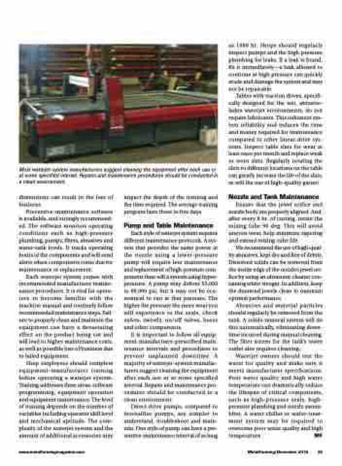

 Most waterjet-system manufacturers suggest cleaning the equipment after each use or at some specified interval. Repairs and maintenance procedures should be conducted in a clean environment.

It is important to follow all equip- ment-manufacturer-prescribed main- tenance intervals and procedures to prevent unplanned downtime. A majority of waterjet-system manufac- turers suggest cleaning the equipment after each use or at some specified interval. Repairs and maintenance pro- cedures should be conducted in a clean environment.
