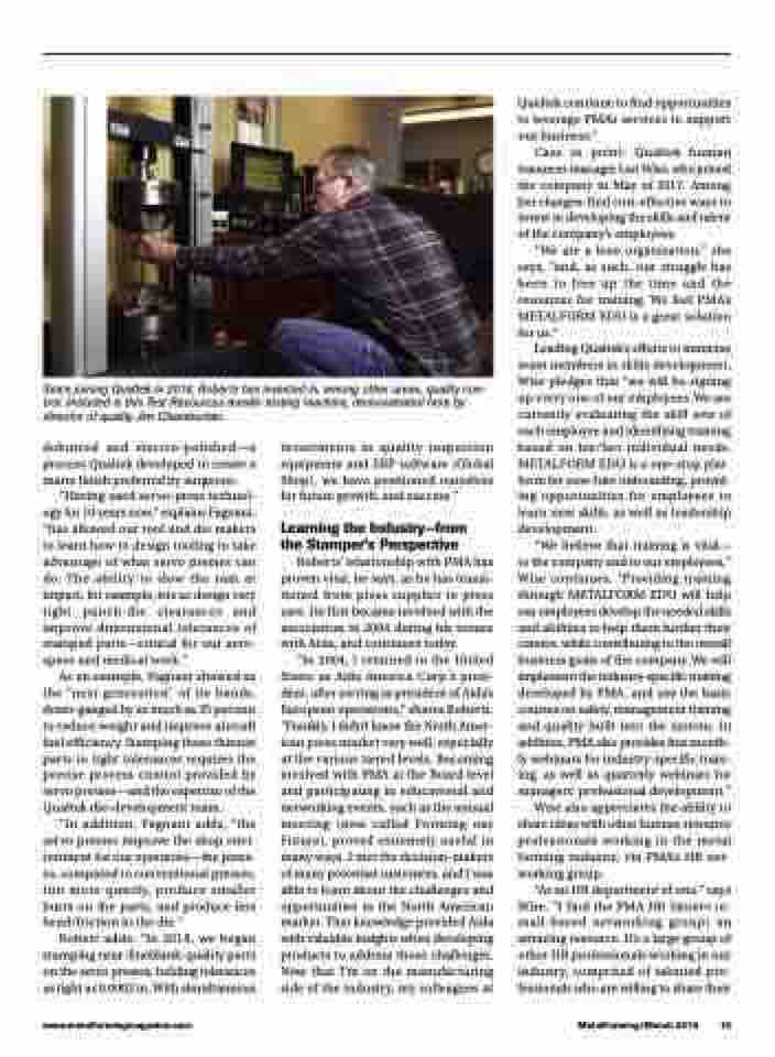

  Since joining Qualtek in 2016, Roberts has invested in, among other areas, quality con- trol. Included is this Test Resources tensile-testing machine, demonstrated here by director of quality Jim Chamberlain.
