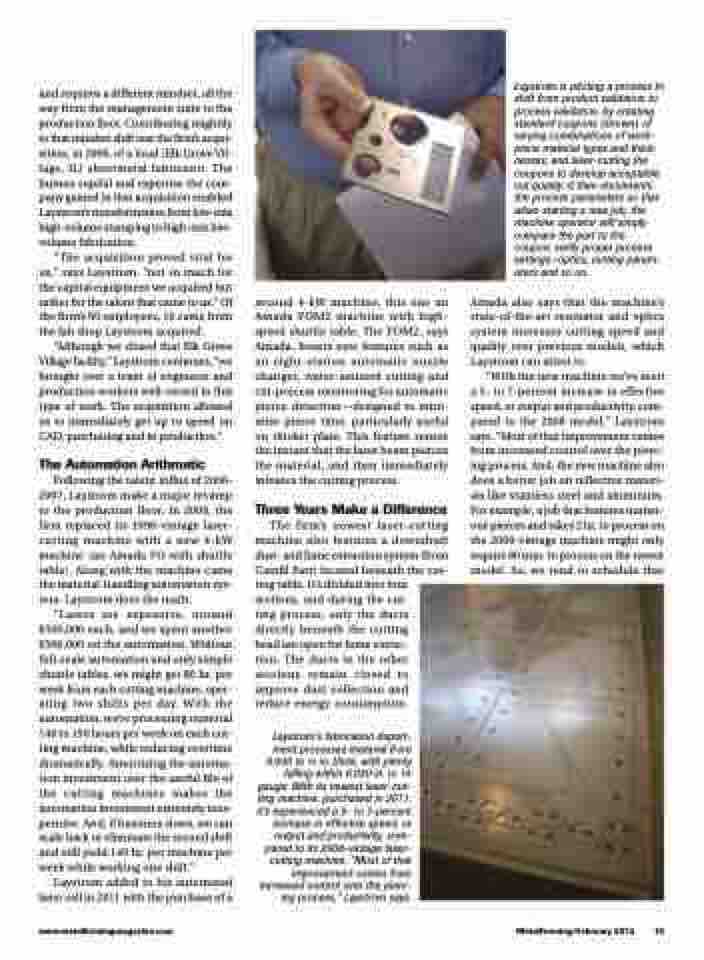

Laystrom’s fabrication depart-
ment processes material from 0.030 to 1⁄4 in. thick, with plenty falling within 0.030 in. to 14 gauge. With its newest laser-cut- ting machine, purchased in 2011, it’s experienced a 5- to 7-percent increase in effective speed, or output and productivity, com- pared to its 2008-vintage laser- cutting machine. “Most of that improvement comes from increased control over the pierc- ing process,” Laystrom says.
Laystrom is piloting a process to shift from product validation to process validation, by creating standard coupons (shown) of varying combinations of work- piece material types and thick- nesses, and laser-cutting the coupons to develop acceptable cut quality. It then documents the process parameters so that when starting a new job, the machine operator will simply compare the part to the coupon, verify proper process settings—optics, cutting param- eters and so on.
Amada also says that the machine’s state-of-the-art resonator and optics system increases cutting speed and quality over previous models, which Laystrom can attest to.
“With the new machine we’ve seen a 5- to 7-percent increase in effective speed, or output and productivity, com- pared to the 2008 model,” Laystrom says. “Most of that improvement comes from increased control over the pierc- ing process. And, the new machine also does a better job on reflective materi- als like stainless steel and aluminum. For example, a job that features numer- ous pierces and takes 2 hr. to process on the 2008-vintage machine might only require 80 min. to process on the newer model. So, we tend to schedule that
