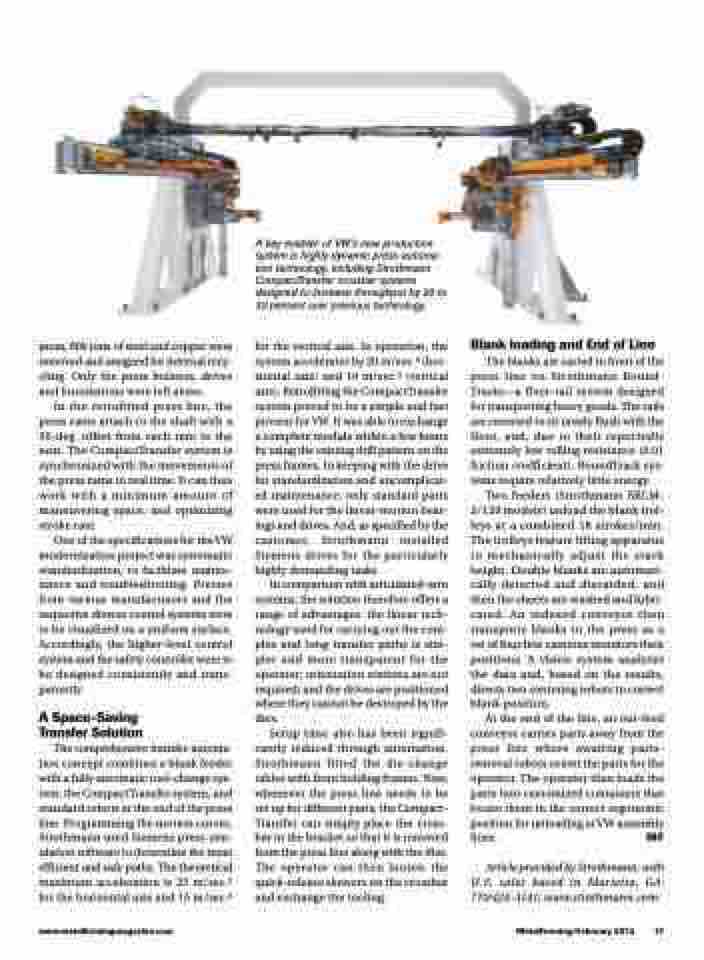

A key enabler of VW’s new production system is highly dynamic press-automa- tion technology, including Strothmann CompactTransfer crossbar systems designed to increase throughput by 20 to 30 percent over previous technology.
for the vertical axis. In operation, the system accelerates by 20 m/sec.2 (hor- izontal axis) and 10 m/sec.2 (vertical axis). Retrofitting the CompactTransfer system proved to be a simple and fast process for VW. It was able to exchange a complete module within a few hours by using the existing drill pattern on the press frames. In keeping with the drive for standardization and uncomplicat- ed maintenance, only standard parts were used for the linear-motion bear- ings and drives. And, as specified by the customer, Strothmann installed Siemens drives for the particularly highly demanding tasks.
