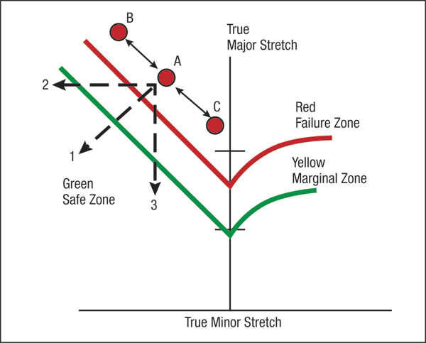

Fig. 2—Both decreasing (B) and increasing (C) metal flow from the binder changed the amount of stretch but not the forming severity. Changing the process along paths 1 thru 3 is required for successful stampings.
First, our specialist created the circle grid and forming-limit diagram (FLD) to numerically define the formability problem. With 100 percent failures, stretch measurements required a gridded blank taken just prior to failure. Continued formation of the stamping from the start of tearing to the home depth can dramatically change the stretch mode, direction and magnitude. Here, home-depth data are misleading. Incremental (breakdown) stampings determined punch stroke length at initial onset of local necking or failure initiation.
Next, the stamper formed a gridded stamping to that critical depth and made grid measurements. The circles evolve into ellipses (Fig. 1). The long axis represents major stretch, or largest positive stretch, and the minor stretch is perpendicular to the major stretch—this may be positive, zero or negative. For our case study, the critical ellipse A plots on the left side of the FLD (Fig. 2). Its position above the forming-limit curve (FLC) before reaching home depth confirms the very high rate of tearing. Additional gridded blanks were formed with decreased (B) or increased (C) material flow from the binder. This change in flow did not change the forming severity of the stamping. Since the changes along B-A-C were aligned on a constant thinning line (Fig. 2), no change in thickness was expected.

At a stamping depth 0.75 in. above home, the failure zone major stretch of yy percent by minor stretch of xx percent exceeds the FLC for the tryout steel. Increasing or decreasing material flow from the binder moves the data point up or down along the constant-thinning line, but does not change the amount of thinning or the forming severity (Fig. 2).
The circle grid and FLC also provide data for step two—numerical definition of the end goal or completion target. Fig. 2 indicates that the major/minor strain combinations must move into the green safe zone. For suggested paths 1, 2 and 3, the required final stretch values are automatically defined. Additionally, the grid ellipses indicate the major stretch directions in the material surrounding the failure site. This information highlights the direction of restrained sheetmetal flow. Instead of making blind deformation changes in the deformation zone, specific targeted changes can be made. Changes in workpiece-material properties, lubrication, tool design and other process parameters also can be studied for a new defined end goal. Then, step three—numerical progress tracking—simply requires plotting data points from initial point A toward the goal defined in step two.
