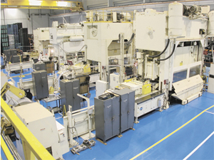

This pressroom utilizes under-floor scrap removal, resulting in a clean and safe manufacturing floor where workers need not handle or transport scrap.

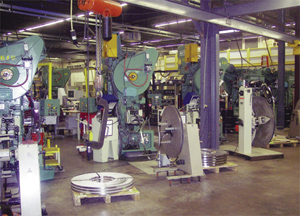

The use of cranes or hoists (top) can help alleviate pressroom ergonomic risks.
