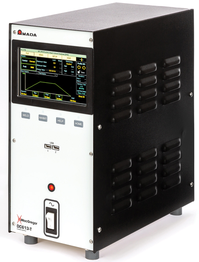

Amada Miyachi America, Inc., announced complete product and sales support for the DC1013-T and DC613-T series of linear DC resistance spot welding power supplies, manufactured by sister company MacGregor. Typically used in aerospace, medical and electronic assembly applications, the units reportedly are ideal for butt welding fuses, welding components to leadframes, gold ribbon bonding and welding fine wire to pads. High-speed automation and communication ports enable full remote-control capability.
The DC1013-T and DC613-T series incorporate statistical process control data collection and reporting capability via Ethernet. And, the 1000-A power supplies combine touch-panel integrated database process control and monitoring with a high-accuracy, zero-ripple linear transistor output stage that delivers 10 micron/sec. dynamic process response rates, with absolute closed-loop 1-A incremental accuracy and repeatability.
Operators can select constant current, voltage and power modes with programmable multi-pulse combinations in 1-A steps to 1000 A. Programmable part and weld checking is coupled with optional displacement and force-limit checking. The DC1013-T offers three-phase operational variants, while the DC613-T supports single-phase operations.
With access to full TCP/IP Ethernet interfacing to internal and external SPC database systems, operators can view both PDF and text-format work instructions and process manuals with weld schedules, and can view image files with weld schedules for quality control and process checking.
