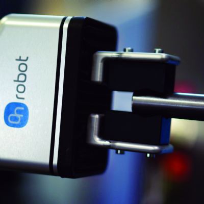

Foote also expresses interest in automated machine and press tending, particularly using cobots, “a much more affordable and flexible option than using traditional robots,” he says. “I am particularly interested in looking at cobots for tending electric press brakes, as well as some of our straightside stamping presses. My only concern is that we tend to be a high-mix shop in those departments, with lot sizes typically under 10,000 parts. I’m not sure that cobots make sense on lower part volumes, but we’re looking at it.”
