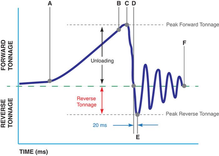

To better visualize what occurs during a typical blanking operation, refer to Fig. 1.
tooling-by-design-force-time-curve-blankingThe Y axis depicts press force in terms of forward (positive) tonnage and reverse (negative) tonnage. The dashed horizontal line represents zero tons. The X axis represents cycle time in milliseconds (ms). The curve shows the rapid buildup and release of press forces with respect to time during the working portion of the press cycle.
As the ram travels downward, the die contacts the work material at point A. Resistance builds quickly as the slide is counter-pressured upward—eliminating all clearances in the mechanical connections between the slide and the press crown. As the ram continues to descend, it builds force until reaching the shear strength of the material (point B). The punch begins to penetrate the material until it overcomes the strength of the material (point C) and the blank fractures (breaks) free.
The steep incline downward illustrates the release of energy after fracture. At point D, the curve passes below the zero-tonnage line where a negative force (reverse tonnage) is generated in the press frame (point E).
For most blanking applications, the complete energy release portion of the cycle occurs within 20 ms. From load-monitoring systems and knowledge of press deflection, it has been shown that the energy release can generate downward slide accelerations approaching 10 g, or 10 times the acceleration of gravity (Wonsetler and White, The Use of Hydraulic Shock Dampers to Arrest the Reverse Load of Blanking Presses, W-Technologies, Inc., 2002).
Finally, the elastic deflection stored in the press frame dissipates through high-frequency oscillations occurring between points E and F.

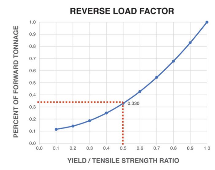

The ratio of material yield strength (YS) to ultimate tensile strength (UTS) was reported to be a critical factor in determining the amount of forward tonnage converted to reverse tonnage when blanking in a press (Wonsetler and White). Empirical tests were conducted to predict the unloading force (Fu) as a function of the YS/UTS ratio:
Fu = [0.893 (YS/UTS)2 ] + 0.107
When plotted as a graph, the strong relationship that the ratio of yield strength to tensile strength has on reverse loading can be observed (Fig. 2). Use this graph to estimate the reverse tonnage produced by a blanking process without dampers.
Assume a 24-in.-dia. blank produced from 0.182-in.-thick steel with 30,000 psi YS and 60,000 psi UTS. The YS/UTS ratio here: 0.5.
Find the reverse-load factor from the curve for 0.5 YS/UTS ratio. This example yields a reverse-load factor of 0.33.
Next, estimate the force (tonnage) required to produce the blank:
P x t x Ss/2000  = 308.7 tons
where
P = part perimeter (24 in.)(π) = 75.40 in.
t  = material thickness = 0.182 in.
Ss = material shear strength = 45,000 psi
Obtaining accurate shear stress data (Ss) is quite difficult; thus, we use approximations. The approximate shear strength of mild steel measures between 70 and 80 percent of its tensile strength. The above example used 75 percent.
Now multiply the estimated blanking force by the reverse load factor:
308.7 x 0.33 = 101.87 tons
The result must be less than the rated capacity of the press in reverse load.
An 800-ton press with a 10-percent reverse-tonnage rating would be overloaded in reverse tonnage (101.87 tons) even though the blanking tonnage (308.7 tons) falls well within the forward-tonnage rating of the press. This is critical information for the die designer as the proposed process must change.
