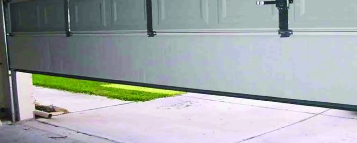

2-Balanced-Garage-Door-Tooling-By-Design-UlintzPress-ram counterbalance systems can be found on all but the smallest presses. The purpose of the counterbalance system: offset or neutralize the weight of the press ram, its connections and the upper-die assembly.

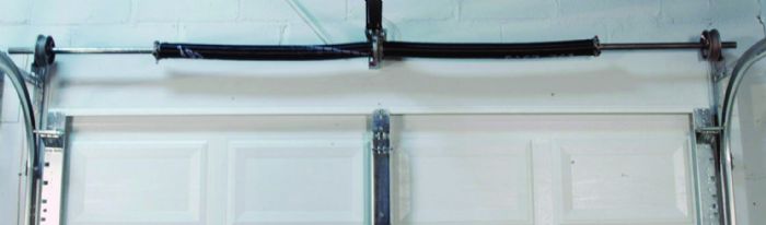

A typical garage door represents a good example of counterbalancing. Torsion springs mount above the garage door (Fig. 1). Anyone having experienced a broken torsion spring knows firsthand that the weight of the garage door suddenly becomes enormous. When a garage-door spring breaks, there’s no stopping the downward travel of the door before it reaches the ground. Conversely, trying to raise the door usually requires more than one person, each exerting a great amount of force to move the door a small amount.
3-Spring-Counterbalance-System-Power-Press-Tooling-By-Design-UlintzWhen replaced, garage-door springs also are adjusted to counterbalance the weight of the door. When properly adjusted, the door can be closed to the halfway position easily and held there with little effort (Fig. 2). Stopping the garage door’s upward or downward movement can be accomplished quickly and with little force.
We look for these same attributes in a press ram: easily lists and closes, stops quickly with little effort, and is held easily in its stopped position.

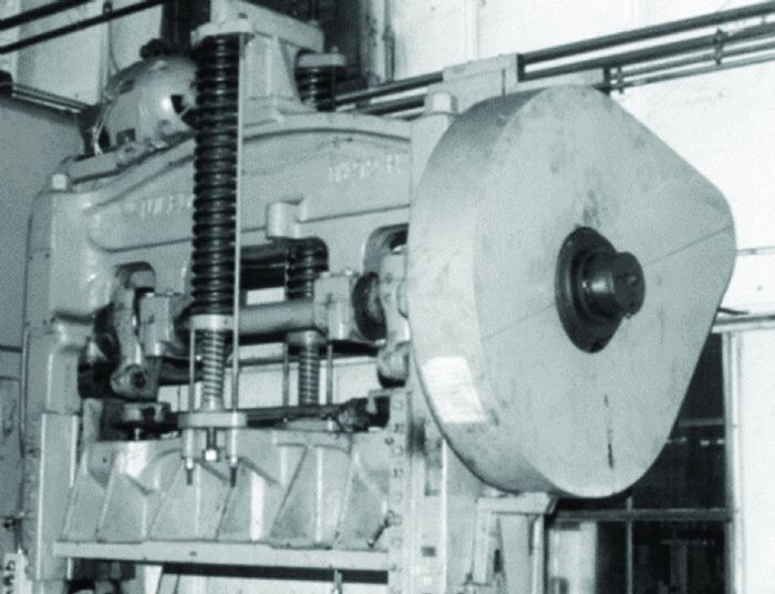

Coil-spring counterbalances in older power presses served a similar purpose as coil springs on garage doors (Fig. 3). These springs were adjusted until the press ram, with its die attachments, would hold at midstroke (90-deg. rotation) without the brake applied.
Today, air counterbalance systems represent the most common method of counterbalancing mechanical power presses. These systems require the press technician to adjust a pressure regulator to a value that will neutralize the weight of the slide and its upper attachments. Most presses include a chart attached to the press that specifies the correct pressure setting for various upper-die weights. Some presses have an automatic counterbalance-adjustment feature.

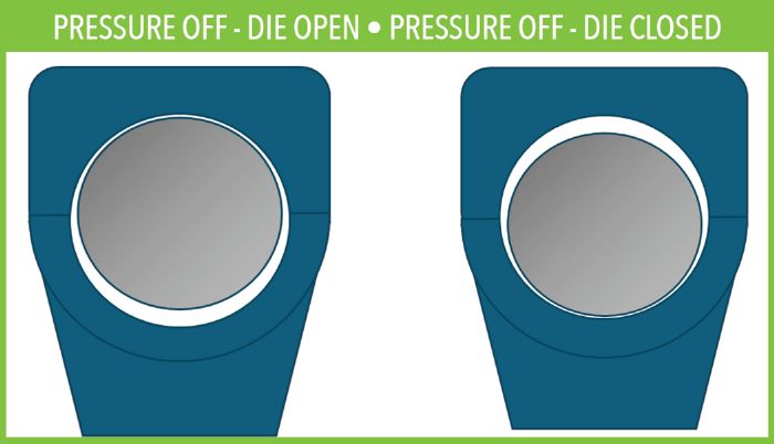

Underbalanced Conditions
An underbalanced condition occurs due to insufficient air pressure in the system, or due to pressure being completely turned off. Fig. 4 illustrates what happens due to low or no counterbalance pressure. At left, the weight of the pitman connection and ram hang on the shaft journal due to gravity when the ram is at the top if its stroke. The white area between the shaft journal and the connection represents running clearance (for lubrication) between the pitman bearing and shaft. (This has been exaggerated in the illustration for emphasis.)
When the die closes, reaction forces move the ram and its connections upward, taking up the clearance on the underside of the shaft. During production, this translates to constant hammering between the shaft and the press connections that eventually damages the press. Underbalancing also increases ram stopping time, brake wear and force reversals.
A properly balanced system lifts the ram and its connections so that the lower side of the journal stays loaded (excess clearance taken up) throughout the press stroke, eliminating the effects of gravity and reducing hammering of the connection. On the upstroke, the electric motor’s energy serves to regain flywheel speed lost during stamping of the part rather than being wasted on lifting the underbalanced ram.
