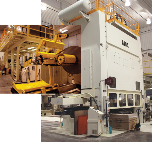

Batesville Tool & Die invested $10 million to build a new addition to its 255,000-sq.-ft. plant and acquire two new big-bed presses, including this Aida 800-ton two-point servo-drive press. The addition boasts a ceiling height of 32 ft. to accommodate larger presses, and an expandable under-floor scrap conveyor that moves scrap outdoors. A Coe servo-feed line delivers material to the press from 72-in.-dia. coils; material capacity is 0.090 in. thick by 60 in. wide to 0.312 in. thick by 12 in. wide.

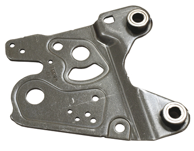

The servo-drive press stamps these seat side brackets, of 0.156-in.-thick 80-KSI high-strength low-alloy steel, two-out from 15-in.-wide strip over 10 die stations. While stamping the brackets on a conventional press created excessive snapthrough, the flexibility and controllability of the servo-press has reduced snapthrough to a manageable 55 reverse-tons. Flatness on the part’s coined sections has been improved, and press speed has increased by more than 15 percent.

Describing the first production job run on the servo-drive press, Jay Fledderman describes the productivity and quality gain realized from moving a progressive die from a conventional 1200-ton press to the servo-drive press.
“The die stamps seat side brackets,” Fledderman says, “to the tune of 36,000 parts/week, about 20 percent of press capacity.” Brackets are of 0.156-in.-thick 80-KSI high-strength low-alloy steel. They’re stamped two-out from 15-in.-wide strip over 10 die stations.

We had run the job for years on one of our two 1200-ton presses,” he continues, “learning to live with and compensate for as much as 145 tons of reverse tonnage. While the addition of hydraulic dampers on the press brought snapthrough force down to 115 tons, our press operators and diesetters found the dampers burdensome and cumbersome.”
Moving the part to the servo-drive press and redesigning the process to reduce ram speed at certain portions of the stroke, during piercing and coining, brought snapthrough down to a manageable 55 reverse tons.
“We’ve found the press to be extremely adjustable in terms of how many times within each stroke we can specify ram speed,” says Robert Holtel, vice president of tooling. “This capability not only helps with snapthrough, but it also improves flatness on coined sections of the bracket, and has reduced the amount of adjustments we need to make within the tool for the form shape. Before, the hit at the bottom of the stroke was so brief that we had to overform to control part dimensions on springback. This proved very inconsistent. To get servo-press-like performance on the 1200-ton mechanical press, we would have had to add a couple of restrike stations to the die.
“With the servo-drive press, we nearly stop at bottom,” Holtel continues, “while overall cycle time has decreased by more than 15 percent, with the press running at 40 strokes/min. Scrap rate is down, and we have fewer, if any, broken punches.”
