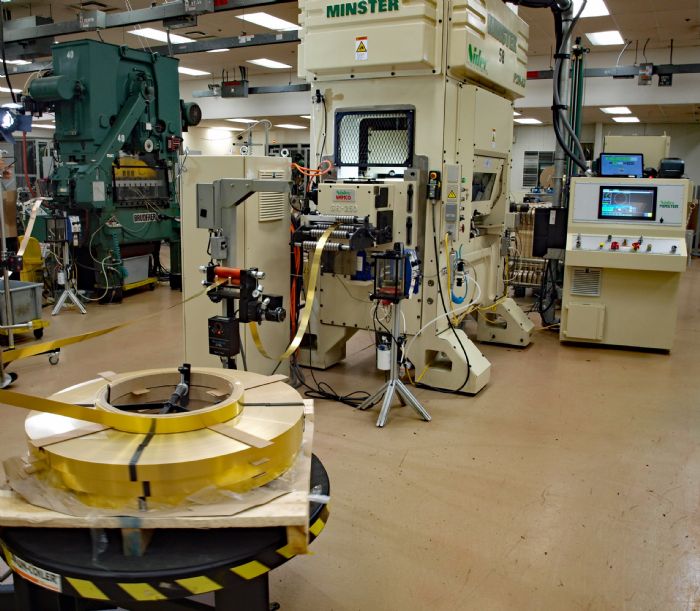

At the heart and soul of Weiss-Aug Co. is high-speed progressive-die stamping of disposable medical devices, including drug-delivery products, orthodontics, ophthalmic disposables and devices, and electrosurgery products. And, while it traditionally has been an ultra-high-speed (800 strokes/min. or more) specialist, recently Weiss-Aug has seen the need to supply larger automotive and medical stamped components. That led, earlier this year, to the firm acquiring the new Nidec Minster equipment for the New Jersey facility. In addition, it recently added two new press lines to boost capacity and upgrade the capabilities of The Diemasters facility: a 350-ton straightside press (a Nidec Minster E2H-350 HeviStamper) equipped with a CHS servo feedline; and a 200-ton straightside press (a new Nidec Minster E2-200 model).
And, not to be outdone, the firm’s Mexico facility in Monterrey recently took delivery of a pair of Nidec Minster factory-certified used P2H-160 straightside presses. In all, the New Jersey facility runs 34 presses, “and most of them are all new within the last 6 years,” says Weissenrieder, “including 11 new high-speed presses.”
Stamping manufacturing manager Drew Taormina explains the move to straightside presses:
“When I came here (in mid-2016), Dieter and I put together a plan for refurbishing our pressroom, focusing on our bigger presses, 60 tons and up. When we performed a cost-value analysis based on the types of products that we were stamping in our high-speed department, and where we wanted to grow, strategically it made more sense to invest in larger presses and focus on equipment reliability and durability rather than on pure speed. When we saw how the Nidec Minster presses were designed and built using the single-piece cast frame and low reverse tonnage, in the end the cost-value benefit favored them. And, the new presses allow us to not only move some tooling over from the high-speed presses, but also let us take on larger stampings than we typically run on our high-speed lines.”

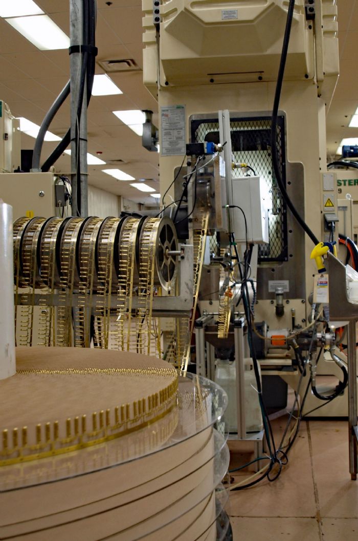

Two of the three new straightside presses in East Hanover, none of which run at speeds more than 450 strokes/ min., are dedicated to specific medical-product lines, including a device used in laser corrective-eye surgery. The third press runs three different dies, including one to stamp brass electrical connectors (1.5-in. strip width, 0.012-in.-thick material) and another to stamp 0.020-in.-thick stainless-steel blades used in surgical procedures.
“Running these dies on the new presses,” explains Taormina, “compared to running them on a high-speed press, has greatly improved part quality and dimensional repeatability. One particularly difficult part requires rolling stainless steel sheet into a barrel shape and then coining the blade.”
Moving these tools for the high-speed presses over to the new straightsides required some engineering ingenuity from the Weiss-Aug team. “We had to retrofit the new presses in order to fit the dies,” says Taormina, “since bottom dead center of the straightside sits 1 to 2 in. above that of the of the high-speed presses. So, we custom-built a bolster addition for each straightside to adjust for new die height—a bolster on a bolster, which also allows us to add conveyors and scrap shakers underneath the dies.”

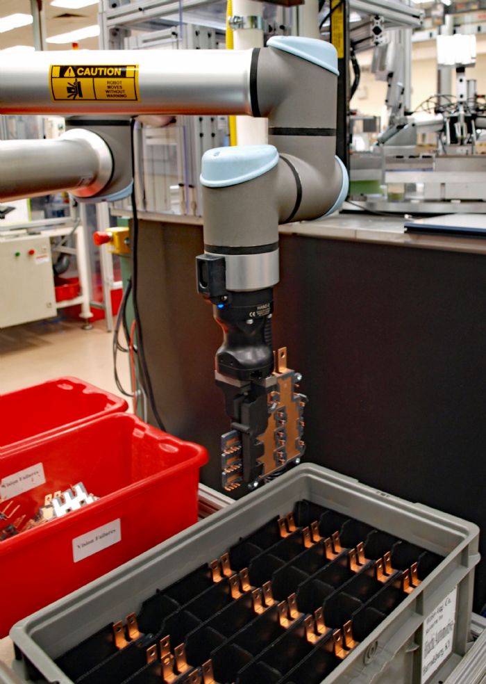

“Seeing us investing in new equipment also helps engage our new hires,” adds Weissenrieder-Bennis. “I think that we impress them with the level of investment here, in automation for example.”

“We average 8 interns/yr.,” Weissenrieder-Bennis says, “primarily co-op students that stay with us for an entire summer. And many come back to work for us after graduation—we probably hire two or three former interns each year. Much of our team came from these two schools, and in fact we just invested in a new laboratory for NJIT, equipped with a machining center with robotic loading/unloading, and a CMM with a cobot. If we can hire two good engineers from there every year, it will pay off.” MF
