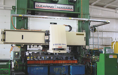

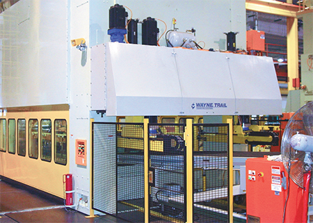

To use a through-the-window transfer, the stamper would have to relocate the press feed, which increases the production footprint and could disrupt production workflow. Here, front-and-back transfers are a better solution—the module placement would not interfere with the press feed, keeping the current press-feed line intact.
Another factor: Based on the type of application, coil width can directly impact which servo-transfer solution to employ. With a front-and-back transfer, the modules take up far less real estate than an upright or through-the-window transfer. The tooling bar travels the length of the through-the-window press with the size of the tooling bar often dictated by the left-to-right dimension of the press, with a longer length requiring a larger tooling bar. This leaves reduced space for coil width. A lack of proper coil-width space reduces the range of automation capabilities on a press.
While both systems allow die access, a through-the-window transfer system is ideal if frequent access to the die is required. Transfer-drive mechanisms on both ends and the ability to uncouple the tooling bar ease access.
Front-and-back transfers are positioned in front of or behind the die so that the module can be run and parked in a full-up position for die access. However, when additional access is needed, longer transfer-mounting frames can be supplied, allowing the transfer module to be shifted laterally away from the press bed and parked in the offline position.
