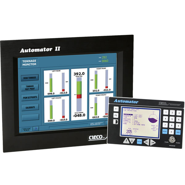

While information is king in complex processes, simplicity and screen design can make all the difference. So notes Chris Cejer, senior vice president of Cieco Controls, whose Automator II press control is shown here. |

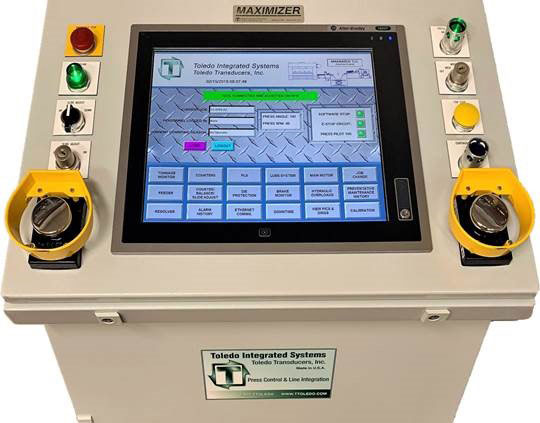

Stampers are requiring more and more from their press controls—for traditional chores such as die protection and tonnage monitoring, but also for “communication and the ability to share information and integrate safety data between the other press-line equipment including feed lines, transfer systems and unloaders,” says John Eby, product manager at Toledo Integrated Systems. “With this level of line integration, stampers benefit from having a ‘smarter’ control that helps them quickly determine downtime reasons, improve overall press-line safety and improve productivity.”
As noted earlier, use of off-the-shelf PLC components enables the addition of built-in Ethernet connectivity with standard protocols. “The desired information (production and downtime data, for example) can be displayed,” Eby adds, “and made available to the stamper. Another advantage with PLC systems is that we quickly can adjust or change the information being requested to fit the user’s exact needs, and we can display additional pieces of information such as part pictures with important production details, press-control electrical schematics and control manuals.”

Stampers are requiring more and more from their press controls—for traditional chores such as die protection and tonnage monitoring, but also for “communication and the ability to share information and integrate safety data between the other press-line equipment including feed lines, transfer systems and unloaders,” says John Eby, product manager at Toledo Integrated Systems. Shown is Toledo’s Maximizer PLC-based fully integrated press automation and control system. |

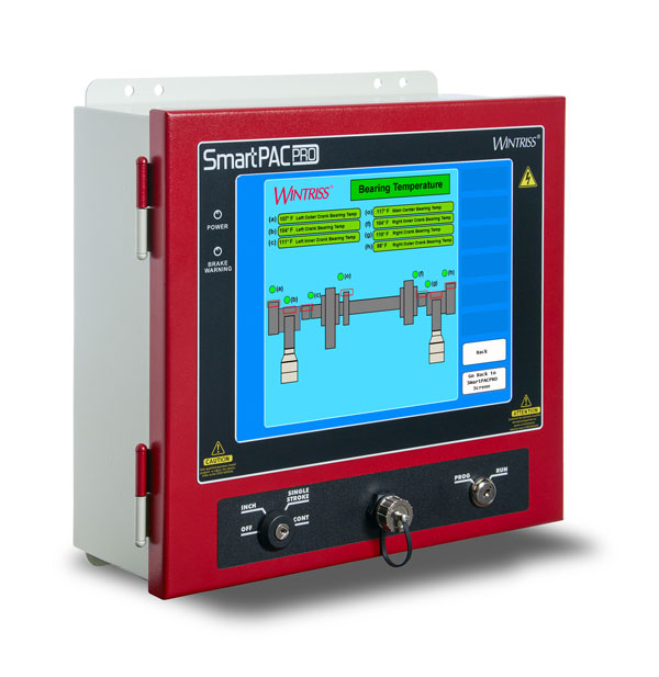

As far as press-control programming goes, “that’s an exciting topic,” says Finnerty. We’ve got die protection down pat. Now, processing power is king. For example, our new SmartPac Pro offers about five times the processing power of our previous control, and there’s 130-times more memory.”
What does more memory and horsepower mean to the stamper? “We’re able to add more capability without adding complexity,” Finnerty continues. “Added die protection functionality is a perfect example. We can program the control to purposely ignore faults during a certain portion of the stroke on certain sensor types. In addition, we can offer very flexible monitoring logic, allowing users to specify that a sensor has to be on or off during certain periods, and we have the onboard memory to store all of these parameters for all of the dies in inventory.” MF
