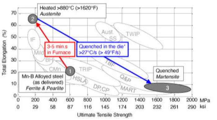

  1. Fig. 1Direct process—The most common hot stamping process, direct hot stamping, or press hardening, finds use on Al-Si-coated or uncoated blanks. The undeformed blank is heated in a furnace over its austenitization temperature (Ac3), approximately 1450-1550 F (780-840 C). The heated blank then is formed (at ➋ in Fig. 1) and subsequently quenched in the same die.
  2. Indirect process—Typically used for galvanized blanks, indirect hot stamping, or form hardening, starts by cold forming the part (at ❶ in Fig. 1). The part then is pierced and trimmed, almost to the final shape, heated in a special furnace and quenched in a second die set.
  3. Hybrid process—Here, some of the forming occurs at the cold stage (❶). The semi-formed part then is heated in the furnace, significantly deformed to a final shape (➋) and quenched subsequently in the same die. This process typically has found use in Europe, with a special varnish-type coating. Since the early 2010s, the process has been abandoned and replaced by the direct process on Al-Si-coated blanks.
  4. Multistep process—For use on air-hardening steels, multistep hot stamping occurs in a transfer press (preferably servo-driven) and then the formed part is air-quenched. At least one OEM in Germany uses this process on galvannealed parts. This is the most recent process route in hot stamping.
Hot Stamping of 22MnB5
The uncoated ultra-high-strength steel originally designed for the hot forming process is 22MnB5 (also called PHS 1500 or HPF 1470). It has a yield strength of approximately 1000 MPa, and a 1500-MPa tensile (145,000 and 215,000 psi respectively) strength after hot stamping. These grades have a minimum 5-percent total elongation, depending on the type of tensile test.

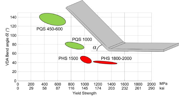

  • Fig. 2Energy-absorbing steel grades—Since their first use, press-hardening steel (PHS) grades were used in the safety cage and in areas requiring high yield strength. Car bodies require deformation resistance (i.e., high yield strength) and the ability to absorb energy (i.e., elongation times strength). Initially, steelmakers focused on developing grades with 450-600-MPa tensile strength (65,000-87,000 psi), with a minimum 13 to 16-percent total elongation after quenching, depending on the strength level. Since these grades were not hardened in the press, they became known as press-quenched steels (PQS).
  • Since the late 2010s, steelmakers have introduced a second PQS family: grades with a yield strength greater than 800 MPa and as high as 1000 MPa (116,000 to 145,000 psi), after bake-hardening treatment. Their tensile strength, on the other hand, ranges from 1000 to 1300 MPa (145,000 to 188,000 psi), and they have a slightly higher total elongation (minimum of 6 percent), compared to PHS1500.New standards for PHS/PQS.
One may ask: What is the benefit of using PQS1000 or PQS1300, compared to PHS1500, since it offers only a slight upgrade in total elongation? In 2010, the German Association of the Automotive Industry (VDA) published a new test standard, VDA 238-100, later updated in 2017. This test calls for bending hardened or quenched samples with a very tight radius, until fracture. The outer angle of bending (α in Fig. 2) provides a measure of energy-absorbing capacity. So, while PQS1000 grades have a yield strength similar to that of PHS1500, they have a higher bending angle.
