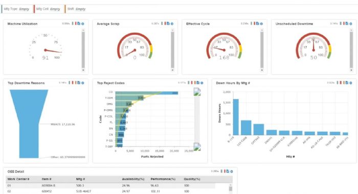

Real-Time Production/Process Monitoring
While historical information plays a valuable role, the most powerful use of sensors on the shop floor comes from combining the real-time data generated via real-time production and process monitoring with a manufacturer’s MES and ERP systems.
At a base level, real-time production monitoring helps to bring meaning to the counts from sensors. In many cases, a production cycle can take mere milliseconds, so metal formers can use production monitoring to capture data based on cycles and then display the information as an average, such as X amount of product/min. or hr. Counts in ERP and MES also support automated workflows, such as material orders, inventory updates, production scheduling, and other shop-floor and accounting processes.
When combined with statistical analysis, real-time production and process monitoring can help metal formers establish parameters for performance, wear, etc. From there, the software can track and flag any production cycles and processes measured by machine sensors that wander outside of an acceptable range. Additionally, MES software can use the data to make decisions about scheduling production, preventive maintenance and other operations.
The actual metrics or key performance indicators (KPIs) that a metal former tracks will be specific to the company’s business priorities. Here we list a few common KPIs that will help optimize operations.
- Throughput. Monitoring may reveal that, when running the same job in two different machines, one machine outperforms the other. With these insights, a metal former can decide to schedule a more time-sensitive work order on the better-running machine and delegate another job to the slower machine.
- Downtime. Downtime monitoring and analysis help sort out scheduled breaks, such as 30 min. of downtime during lunch periods, versus required breaks due, for example, to the need to replenish lubricant supplies. And, the ability to monitor changes in vibration, for example, can provide an early indicator of wear that requires predictive maintenance before it creates a downtime issue.
- Rate of rejected parts. Comparing machine amperage to the number of rejected parts coming from the machine can help provide insight into whether a job is improperly set up, or if there are actual issues with the machine affecting quality.
- Rate of material consumption. Monitoring material consumption in real time can help metal formers keep accurate, up-to-date records of inventories to facilitate purchasing decisions and production planning.
- Lubricant level. Monitoring flow can alert metal formers as to when to replenish supplies before impacting product quality.
While metal formers can track a nearly unlimited number of KPIs with sensors and real-time production and process monitoring, starting with too many KPIs can ground monitoring and analysis initiatives to a halt. So, managers must prioritize establishing a very short list of KPIs most relevant to the business. Then, having regularly been tracking metrics against these KPIs, the company can look at incrementally adding new KPIs.
