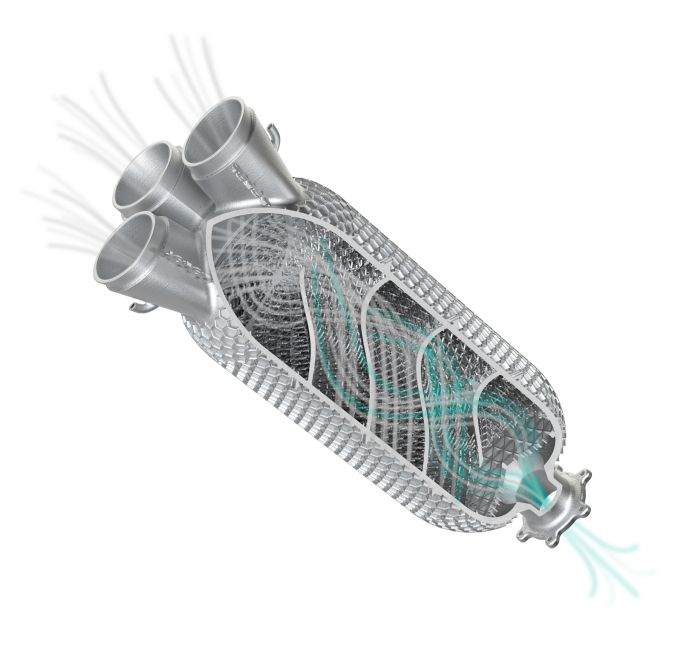

1-3d-systems-stage-1-mechanical-gilterSome relatively simple chemical reactions lie at the heart of carbon capture. Any system for carbon capture and reclamation must operate at extreme efficiency to ensure that it does not add to the problem by consuming carbon-heavy fuels or emitting more carbon into the atmosphere. In other words, we must capture as much carbon as possible while using significantly less carbon than we capture to produce the reaction. Ideally, the goal is zero carbon input for unlimited carbon reclaimed as output.

Mechanical Filters
A critical component of carbon capture involves “catching” the carbon in the first place with a structured mechanical filter, typically coated with an amine that attracts carbon. Air is drawn into the system through the first stage, or the direct-air-contact stage.
Direct-air-contact filter efficiency can be maximized by filter structures that allow for maximum contact between incoming air and the filter surface. AM allows for the function-first design of such filters (Fig. 1), which can induce high levels of turbulence and mixing as well as high surface area for maximum air contact. The challenge: How do we create the maximum amount of surface area with the least pressure drop?
