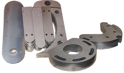

Mazak rates the 4000-W machine installed recently at P&S Metals for cutting mild steel to 1 in. thick, stainless steel to 0.5 in. and aluminum to 3⁄8 in. Positioning accuracy in the x-y directions (rack-and-pinion drives) is 0.002 in./20 in. Perry considers the new cutting machine “the gift that keeps on giving,” because not only has it helped to bring in new customers, but it’s also opened up shop capacity. |

“We acquired our first laser cutter, a 2500-W used CO2 machine, in 2009,” recalls Perry, “and it has proved very productive on steel sheet to about 3⁄8 in. thick. Compared to our workhorse oxyfuel-cutting machine, the cuts were significantly better on that range of material. Customers at that time were demanding better accuracy and the laser provided that. And, cleaner edges meant little to no post-cut edge prep prior to welding.
“More recently,” Perry continues, “our market has created opportunities to grow into high-precision thicker-plate fabrication, ¼ to 1 in., which led us to begin a search for a higher-power cutting system.”
