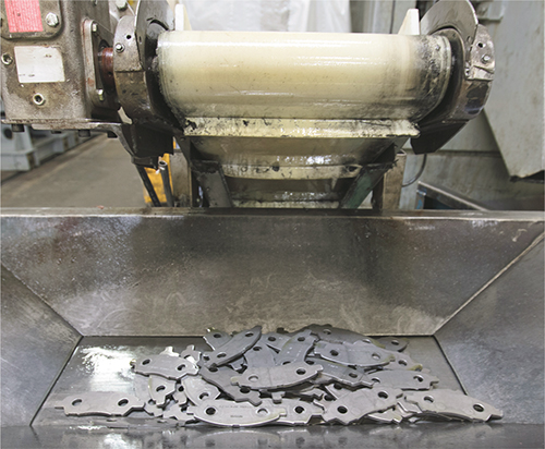

Fineblanking employs complex tooling to produce smooth-profiled finished parts in just one operation or press stroke. Unlike conventional blanking, the tool applies counter-pressure to the blank that allows the part to be cleanly sheared with exceptionally straight edges and particularly good flatness tolerances. Parts do not require secondary machinery operations such as grinding or milling.
“Die clearances are one-tenth of those used for conventional stamping,” says Util director of operations Massimiliano Miletto Petrazzini, “which helps eliminate tearing on the edges of the brake backing plates.”
In addition to a power straightener, the feed line includes a threading table, for hands-free threading; and a coil reel with multiple hydraulic holddowns and motorized end wheels for coil containment. It can process high-strength steels to 620-MPa yield at thicknesses from  3 to 12 mm.
The process employs dies with very tight clearances—one percent or less. Parts that typically are cast and machined can be made with fineblanking in a single press setup, achieving dimensional accuracy (with the material thicknesses UTIL works with) to within ±0.05 mm, and edge perpendicularity to top and bottom faces to within ±0.0125 mm.

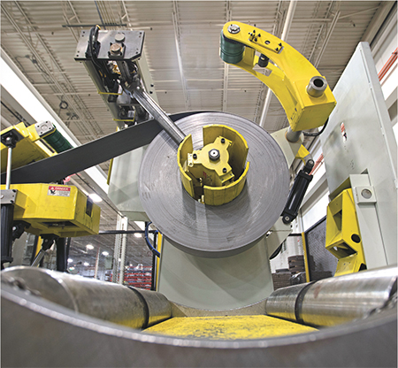

Late last year, Util Canada took delivery of its new fineblanking line, equipped to take its technology to a new level of precision and robustness and help open doors to new customers and new markets. The line features a hydraulic press from Japanese supplier Mori Iron Works Co., fed by a uniquely specified feed line from Coe Press Equipment, Sterling Heights, MI. The feed line features a Coe Fineblanking Edition HD straightener, coil reel with HD holddown arm, and alligator-style peeler-threader. The straightener provides the necessary roll-force delivery and rigidity required to achieve flatness and dimensional-tolerance requirements for producing fineblanked backing plates.
“We typically fineblank a variety of steel grades, including high-strength low-alloy steels,” says Luppis. “Most recently, we’ve been required to fine-blank 8-mm-thick AISI grade 4140 steel (655-MPa tensile strength, 415-MPa yield), a cold-rolled high-tensile alloy (0.75-1.00 Mn, 0.80-1.1 Cr, 0.38-0.43 C). The robustness of the new coil line really proves itself with this material.”
“We needed a straightener that was strong, robust and reliable,” adds Petrazzini. “We must maintain stable consistent production throughput, avoiding unscheduled downtime. The new equipment fits the bill, with overall stiffness of the machine being the critical criteria. When evaluating the machine design, we appreciated that key components were oversized to ensure stable and consistent performance.”
In addition to the power straightener (127 by 610 mm), the equipment setup includes a threading table (610 by 460 mm), for hands-free threading; and a 7000-kg-capacity by 610-mm coil reel with multiple hydraulic holddowns and motorized end wheels for coil containment.
“We can use the line to process high-strength steels 620-MPa yield at thicknesses from 3 to 12 mm,” adds Luppis, “depending on the width of the material. It can achieve a payoff rate to 80 ft./min.”
