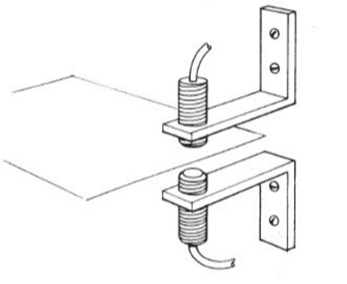

“Typically, we want to know the material type—ferrous or nonferrous—and the range of thicknesses to be run on a particular line,” Vance says. “We also ask if a metal former prefers a probe to contact the material, or if material should pass between a transmitter and receiver in a noncontact dual-probe setup (Figs. 2 and 3), often employed when producing parts with Class A surface finishes. From there, we can recommend an ideal system. Metal formers have a lot of flexibility when looking to home in on the most effective method of double-sheet detection for their needs.”

A system supplier should offer a variety of sensor sizes to fit any line size. For example, Prime Controls can specify barrel sensors in a variety of sizes as well as 2 by 3-in. block sensors for dual-probe applications, such as in transfer-press lines where transfer tooling picks and drops parts at various forming stations, according to Vance.
“Most difficult is finding the correct locations for dual-sensor probes, due to the limited distances (about 3 in. max) in which the probes can be separated from each other,” he explains. “A tight sensing area enables concentration on the material to be detected, whereas extended sensing areas introduce the possibility of interference and unwanted detection.”
