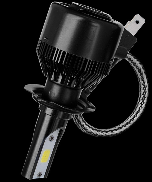

aftermarket automotive LED headlight
This aftermarket automotive LED headlight, resulting from optimized AM, illustrates how AM can succeed in higher-volume automotive applications.

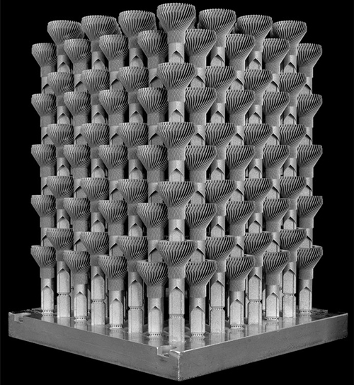

stacked build of automotive LED-headlight heatsinks
A stacked build of automotive LED-headlight heatsinks. Designing the part with in-built support features allowed multiple parts to be stacked on top of each other without the need for additional supports. As a result, finished parts could be snapped apart by hand, without the need for further post-processing.
The right part can help industry break conventional thinking about LPBF. A demonstration can be found in the automotive industry’s switch to the use of LED headlights. Typically, these components require comparatively large, often actively cooled heatsinks. Betatype, which works with customers to deliver functional components through AM, and built Engine, a data-processing platform for managing and controlling multi-scale design, saw an opportunity. The company recognized that the specific geometry for these metal parts made them ideal for producing via LPBF, which can consolidate multiple manufacturing processes into a single production method.
By considering the LPBF process during the component’s initial design stage, Betatype was able to design a part with in-built support features, allowing multiple headlight parts to be stacked on top of each other without the need for additional supports. As a result, finished parts could be snapped apart by hand, without the need for further post-processing.
Full stacking, often deemed difficult with LPBF due to thermal stresses involved in the layer process, was achieved through intelligent design of the structure. This reduced thermal stresses, leading to minimal thermal distortion. Innovative part design enabled a series of parts to be nested to maximize build volume, resulting in 384 parts produced within a single build envelope. UK-based Progressive Technology built the parts using an EOS 280M system.
