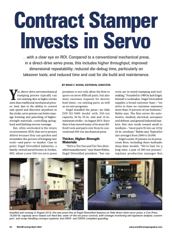

  Installed and running in August 2019, the new press line at Engel Diversified features an Aida direct-drive servo press; a Coe Press 10,000-lb.-capacity servo-based coil-feed line; state-of-the-art press controls, with tonnage monitoring and signature analysis; custom part- and scrap-handling conveyor systems; and ANSI- and OSHA-compliant guarding.
