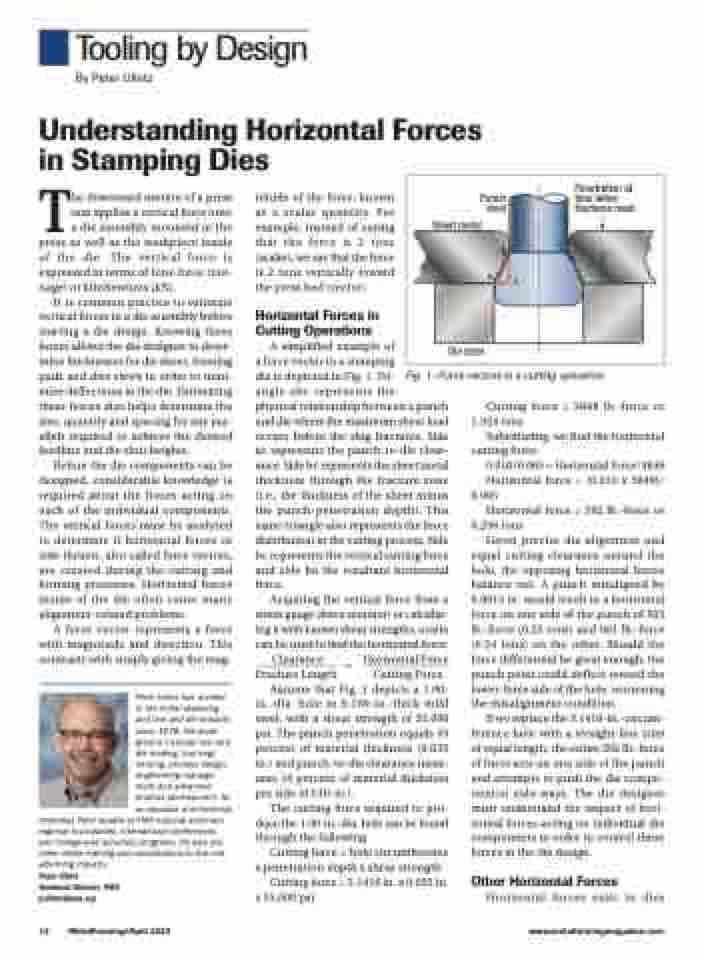

Horizontal Forces in Cutting Operations
A simplified example of
a force vector in a stamping
die is depicted in Fig. 1. Tri-
angle abc represents the
physical relationship between a punch and die where the maximum shear load occurs before the slug fractures. Side ac represents the punch-to-die clear- ance. Side bc represents the sheet metal thickness through the fracture zone (i.e., the thickness of the sheet minus the punch-penetration depth). This same triangle also represents the force distribution in the cutting process. Side bc represents the vertical cutting force and side ba the resultant horizontal force.
Acquiring the vertical force from a strain gauge (force monitor) or calculat- ing it with known shear strengths, a ratio can be used to find the horizontal force:
Clearance = Horizontal Force Fracture Length Cutting Force
Assume that Fig. 1 depicts a 1.00- in.-dia. hole in 0.100-in.-thick mild steel, with a shear strength of 35,000 psi. The punch penetration equals 35 percent of material thickness (0.035 in.) and punch-to-die clearance meas- ures 10 percent of material thickness per side (0.010-in.).
The cutting force required to pro- duce the 1.00-in.-dia. hole can be found through the following:
Cutting force = hole circumference x penetration depth x shear strength
Cutting force = 3.1416 in. x 0.035 in. x 35,000 psi
Fig. 1—Force vectors in a cutting operation.
Cutting force = 3848 lb.-force or 1.924 tons
Substituting, we find the horizontal cutting force:
0.010/0.065 = Horizontal force/3848
Horizontal force = (0.010 x 3848)/ 0.065
Horizontal force = 592 lb.-force or 0.296 tons
Given precise die alignment and equal cutting clearance around the hole, the opposing horizontal forces balance out. A punch misaligned by 0.0015 in. would result in a horizontal force on one side of the punch of 503 lb.-force (0.25 tons) and 681 lb.-force (0.34 tons) on the other. Should the force differential be great enough, the punch point could deflect toward the lower-force side of the hole, worsening the misalignment condition.
If we replace the 3.1416-in.-circum- ference hole with a straight-line trim of equal length, the entire 592 lb.-force of force acts on one side of the punch and attempts to push the die compo- nent(s) side-ways. The die designer must understand the impact of hori- zontal forces acting on individual die components in order to control these forces in the die design.
