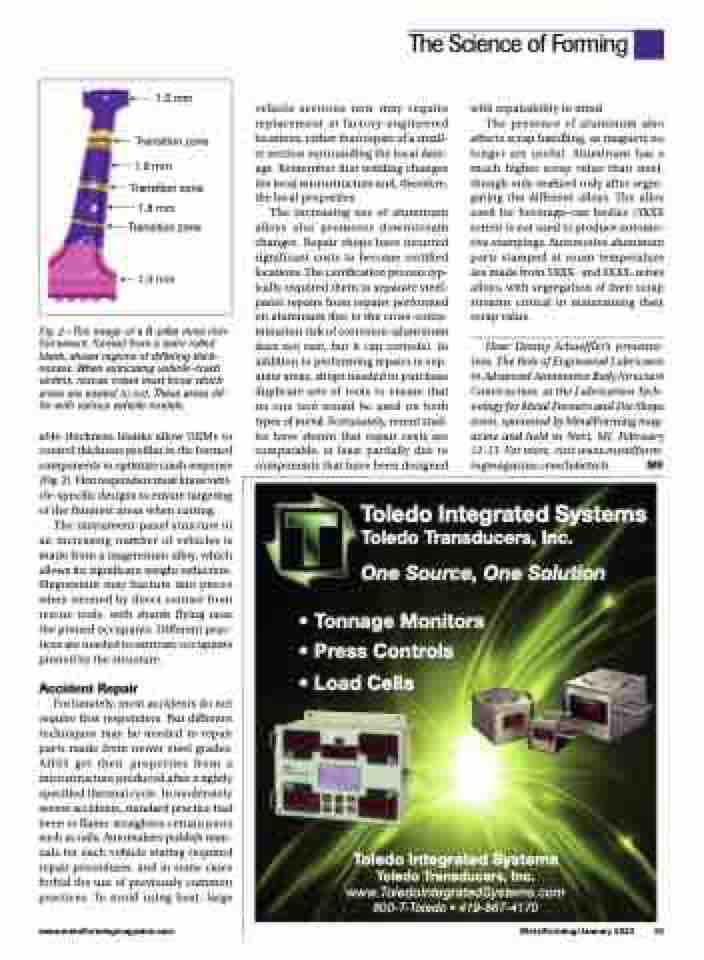

 Fig. 2—This image of a B-pillar inner rein- forcement, formed from a tailor rolled blank, shows regions of differing thick- nesses. When extricating vehicle-crash victims, rescue crews must know which areas are easiest to cut. These areas dif- fer with various vehicle models.
able-thickness blanks allow OEMs to control thickness profiles in the formed components to optimize crash response (Fig. 2). First responders must know vehi- cle-specific designs to ensure targeting of the thinnest areas when cutting.

 1.0 mm
Transition zone
1.9 mm
Transition zone 1.8 mm
Transition zone
1.0 mm
