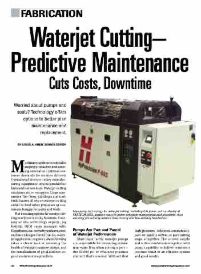

New pump technology for waterjet cutting, including this pump unit on display at FABTECH 2019, enables users to better schedule maintenance and downtime, thus ensuring productivity without time, money and late-delivery headaches.
