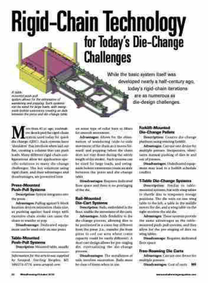

 A table-
mounted push-pull
system allows for the elimination of wandering and popping. Such systems can be sized for large loads, with swing- aside bolster extensions creating an aisle between the press and die-change table.
More than 45 yr. ago, toolmak- ers developed the rigid-chain system used today for quick die change (QDC). Such systems have ‘shoulders’ that interlock when laid out flat, creating a column that can push loads. Many different rigid-chain con- figurations allow for application-spe- cific solutions to many die-change challenges. The key solutions using rigid chain, and their advantages and disadvantages, are presented here.
