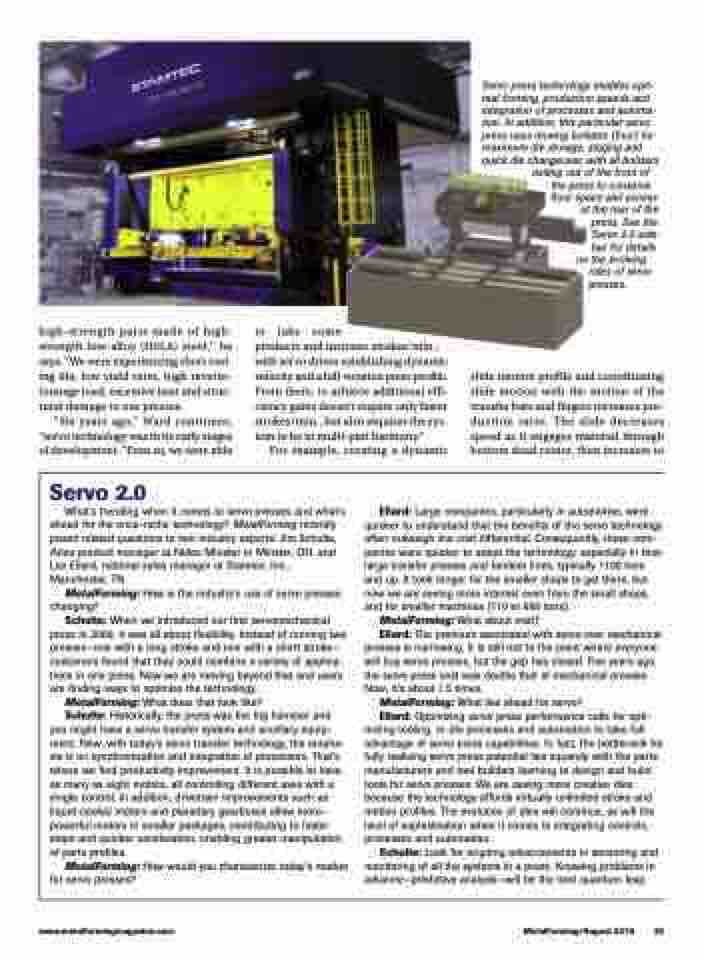

Servo press technology enables opti- mal forming, production speeds and integration of processes and automa- tion. In addition, this particular servo press uses moving bolsters (four) for maximum die storage, staging and quick die changeover, with all bolsters
exiting out of the front of the press to conserve floor space and access
at the rear of the press. See the Servo 2.0 side- bar for details
on the evolving roles of servo presses.
