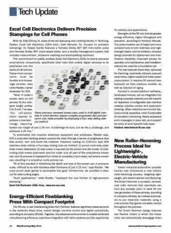

Excel Cell Electronics Delivers Precision Stampings for Cell Phones
With its 108,000-sq.-ft. state-of-the-art stamping and molding facility in Taichung, Taiwan, Excel Cell Electronic (USA) Corp., East Hanover, NJ, focuses on precision stampings. Its Taiwan facility features a Yamada Dobby 80T NXT link-motion press and Yamada Dobby 80T crank-speed press, and a quality-management system that includes measurement, ultrasonic-cleaning and electroplating machines.
This commitment to quality enables Excel Cell Electronic (ECE) to stamp precision smart-phone components, specifically steel cans that enable digital cameras to be positioned into the
backs of cell phones.
These micro compo- nents must be durable and increas- ingly smaller, says Julian Riedler, market developer for ECE.
“Most of today’s
screen cans on cell
phones fit the stan-
dard height profile:
2 to 3 mm,” he says.
“Our cell-phone
client wanted to
achieve a new tech-
nology requiring
screen-can height of just 1.35 mm. A challenge for sure, but we like a challenge, and achieved 1.25 mm.”
To accomplish this requires advanced equipment and processes, Riedler says. ECE’s automatic feeding system pushes the steel through a series of progressive dies that punch, coin and bend the material. Precision cutting on 0.15-mm type 304 stainless steel utilizes a four-step sliding side-cut method: 1) punch-mold side-cutter slide moves downward; 2) side cutter is secured by the punch and die molds; 3) side- cutting slide moves downward, and the cutter cuts off part of the smartphone screen can; and 4) process is repeated four times to complete a four-sided, cell-phone screen can, resulting in a smoother, more precise cut.
“All of this resulted in stretching the depth and size of the screen can in precision scale—difficult to do with stainless-steel thickness of just 0.15 mm,” says Riedler. “We must punch down gently to accomplish this goal. Furthermore, we provided a clean cut for side-cutting edges.
“Such applications,” adds Riedler, “represent the new frontier of high-precision stamping.”

These precision-stamped screen cans, used to hold digital cam- eras in smart phones, require complex progressive dies and pre- cision cuts made possible by employing a four-step sliding side- cut method.
