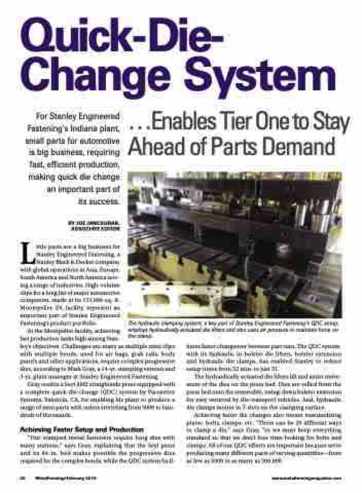

The hydraulic clamping system, a key part of Stanley Engineered Fastening’s QDC setup, employs hydraulically actuated die lifters and also uses air pressure to maintain force on the clamp.

itates faster changeover between part runs. The QDC system, with its hydraulic in-bolster die lifters, bolster extension and hydraulic die clamps, has enabled Stanley to reduce setup times from 52 min. to just 31.
The hydraulically actuated die lifters lift and assist move- ment of the dies on the press bed. Dies are rolled from the press bed onto the removable, swing-down bolster extension for easy retrieval by die-transport vehicles. And, hydraulic die clamps mount in T-slots on the clamping surface.
Achieving faster die changes also meant standardizing plates, bolts, clamps, etc. “There can be 20 different ways to clamp a die,” says Gray, “so we must keep everything standard so that we don’t lose time looking for bolts and clamps. All of our QDC efforts are important because we’re producing many different parts of varying quantities—from as few as 5000 to as many as 300,000.
Gray credits a Seyi SM2 straightside press equipped with a complete quick-die-change (QDC) system by Pacesetter Systems, Valencia, CA, for enabling his plant to produce a range of mini parts with orders stretching from 5000 to hun- dreds of thousands.
