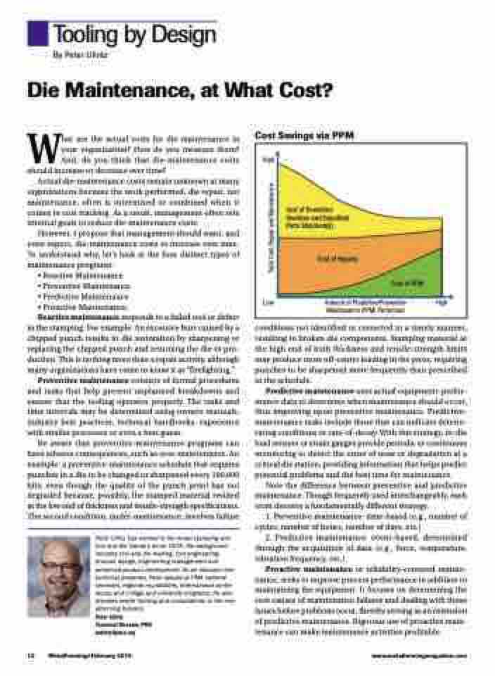

Cost Savings via PPM
High
Cost of Downtime Overtime and Expedited Parts Shipment(s)
Cost of Repairs
Cost of PPM
Low
Amount of Predictive/Preventive High Maintenance (PPM) Performed
conditions not identified or corrected in a timely manner, resulting in broken die components. Stamping material at the high end of both thickness and tensile-strength limits may produce more off-center loading in the press, requiring punches to be sharpened more frequently than prescribed in the schedule.
Predictive maintenance uses actual equipment-perfor- mance data to determine when maintenance should occur, thus improving upon preventive maintenance. Predictive- maintenance tasks include those that can indicate deterio- rating conditions or rate-of-decay. With this strategy, in-die load sensors or strain gauges provide periodic or continuous monitoring to detect the onset of wear or degradation at a critical die station, providing information that helps predict potential problems and the best time for maintenance.
Note the difference between preventive and predictive maintenance. Though frequently used interchangeably, each term denotes a fundamentally different strategy.
1. Preventive maintenance: time-based (e.g., number of cycles, number of hours, number of days, etc.)
2. Predictive maintenance: event-based, determined through the acquisition of data (e.g., force, temperature, vibration frequency, etc.).
Proactive maintenance or reliability-centered mainte- nance, seeks to improve process performance in addition to maintaining the equipment. It focuses on determining the root causes of maintenance failures and dealing with those issues before problems occur, thereby serving as an extension of predictive maintenance. Rigorous use of proactive main- tenance can make maintenance activities profitable.
12 MetalForming/February 2019
Total Cost: Repair and Maintenance
