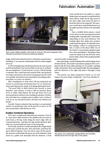

   Parts remain tabbed together until ready for removal. The punch separates them, followed by automatic removal via pneumatic grippers.

Now, a forklift driver places a stock of raw sheets on the automated system’s loading table, typically 200 to 300 sheets depending on size and thickness. The loading table then slides into position underneath the gantry. To eliminate dou- ble loading, a blast of compressed air hits a corner of the sheet while two of the loader’s 12 pneumatic grippers grab the corner and shake it. The gantry then loads the blank from the left side of the punch table, where three programmable
single-sided load/unload system to eliminate manual sheet handling, it can operate unattended until its metal supply runs out.

Previously, operators would manually load a single blank on the press, punch the part, slots and holes, and keep the parts tabbed together. Once the sheet came off the punch, the operator would shake the parts out of the skeleton, stack them on a pallet and manually fold the skeleton. A fork
and relocatable clamps grip it.
After punching, countersinking holes and bending (more
details shortly), the loader’s pneumatic grippers lift a com- pleted wall off of the table and place it on a pallet, stacking walls consistently. After removing all walls, the press grippers pull the skeleton to the right and push it through a drop chute.
“Our punch can make progressive bends, so we now bypass the press brake completely,” says Tony Mendez Jr.,
This gantry runs unattended, loading blanks and unloading finished parts from the right side of the system.
