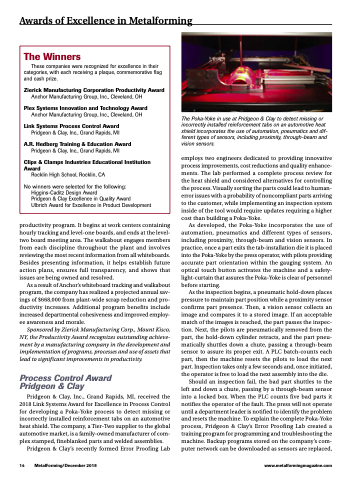

Pridgeon & Clay, Inc., Grand Rapids, MI, received the 2018 Link Systems Award for Excellence in Process Control for developing a Poka-Yoke process to detect missing or incorrectly installed reinforcement tabs on an automotive heat shield. The company, a Tier-Two supplier to the global automotive market, is a family-owned manufacturer of com- plex stamped, fineblanked parts and welded assemblies.
Pridgeon & Clay’s recently formed Error Proofing Lab
The Poka-Yoke in use at Pridgeon & Clay to detect missing or incorrectly installed reinforcement tabs on an automotive heat shield incorporates the use of automation, pneumatics and dif- ferent types of sensors, including proximity, through-beam and vision sensors.
employs two engineers dedicated to providing innovative process improvements, cost reductions and quality enhance- ments. The lab performed a complete process review for the heat shield and considered alternatives for controlling the process. Visually sorting the parts could lead to human- error issues with a probability of noncompliant parts arriving to the customer, while implementing an inspection system inside of the tool would require updates requiring a higher cost than building a Poka-Yoke.
As developed, the Poka-Yoke incorporates the use of automation, pneumatics and different types of sensors, including proximity, through-beam and vision sensors. In practice, once a part exits the tab-installation die it is placed into the Poka-Yoke by the press operator, with pilots providing accurate part orientation within the gauging system. An optical touch button activates the machine and a safety- light-curtain that assures the Poka-Yoke is clear of personnel before starting.
As the inspection begins, a pneumatic hold-down places pressure to maintain part position while a proximity sensor confirms part presence. Then, a vision sensor collects an image and compares it to a stored image. If an acceptable match of the images is reached, the part passes the inspec- tion. Next, the pilots are pneumatically removed from the part, the hold-down cylinder retracts, and the part pneu- matically shuttles down a chute, passing a through-beam sensor to assure its proper exit. A PLC batch-counts each part, then the machine resets the pilots to load the next part. Inspection takes only a few seconds and, once initiated, the operator is free to load the next assembly into the die.
Should an inspection fail, the bad part shuttles to the left and down a chute, passing by a through-beam sensor into a locked box. When the PLC counts five bad parts it notifies the operator of the fault. The press will not operate until a department leader is notified to identify the problem and resets the machine. To explain the complete Poka-Yoke process, Pridgeon & Clay’s Error Proofing Lab created a training program for programming and troubleshooting the machine. Backup programs stored on the company’s com- puter network can be downloaded as sensors are replaced,
