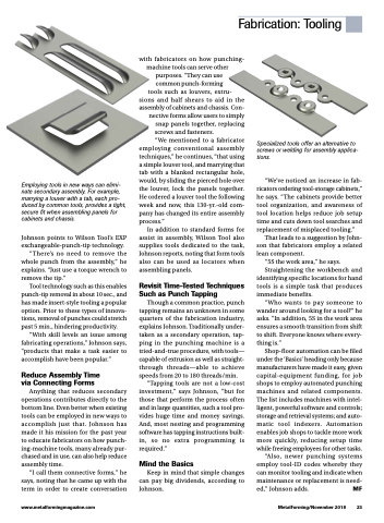

   Employing tools in new ways can elimi- nate secondary assembly. For example, marrying a louver with a tab, each pro- duced by common tools, provides a tight, secure fit when assembling panels for cabinets and chassis.

Reduce Assembly Time via Connecting Forms
Anything that reduces secondary operations contributes directly to the bottom line. Even better when existing tools can be employed in new ways to accomplish just that. Johnson has made it his mission for the past year to educate fabricators on how punch- ing-machine tools, many already pur- chased and in use, can also help reduce assembly time.
“I call them connective forms,” he says, noting that he came up with the term in order to create conversation
with fabricators on how punching- machine tools can serve other
purposes. “They can use
common punch-forming tools such as louvers, extru-
sions and half shears to aid in the assembly of cabinets and chassis. Con- nective forms allow users to simply snap panels together, replacing
screws and fasteners.
“We mentioned to a fabricator employing conventional assembly techniques,” he continues, “that using a simple louver tool, and marrying that tab with a blanked rectangular hole, would, by sliding the pierced hole over the louver, lock the panels together. He ordered a louver tool the following week and now, this 130-yr.-old com- pany has changed its entire assembly process.”
In addition to standard forms for assist in assembly, Wilson Tool also supplies tools dedicated to the task, Johnson reports, noting that form tools also can be used as locators when assembling panels.

Specialized tools offer an alternative to screws or welding for assembly applica- tions.
