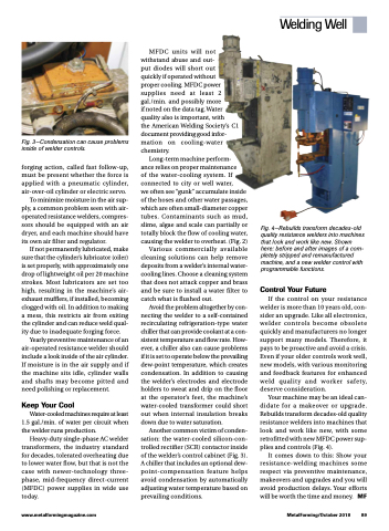

   Fig. 3—Condensation can cause problems inside of welder controls.

Avoid the problem altogether by con- necting the welder to a self-contained recirculating refrigeration-type water chiller that can provide coolant at a con- sistent temperature and flow rate. How- ever, a chiller also can cause problems if it is set to operate below the prevailing dew-point temperature, which creates condensation. In addition to causing the welder’s electrodes and electrode holders to sweat and drip on the floor at the operator’s feet, the machine’s water-cooled transformer could short out when internal insulation breaks down due to water saturation.
Another common victim of conden- sation: the water-cooled silicon-con- trolled rectifier (SCR) contactor inside of the welder’s control cabinet (Fig. 3). A chiller that includes an optional dew- point-compensation feature helps avoid condensation by automatically adjusting water temperature based on prevailing conditions.
Fig. 4—Rebuilds transform decades-old quality resistance welders into machines that look and work like new. Shown here: before and after images of a com- pletely stripped and remanufactured machine, and a new welder control with programmable functions.

Your machine may be an ideal can- didate for a makeover or upgrade. Rebuilds transform decades-old quality resistance welders into machines that look and work like new, with some retrofitted with new MFDC power sup- plies and controls (Fig. 4).
