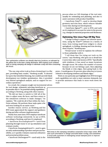

 Trim-optimization software can identify ideal trim locations, as indicated by the yellow line in this laser-cutting illustration. BTD employs such software early on during stamping-die design to eliminate costly and time-consuming die recuts.

Optimizing Trim Lines Pays Off Big Time
“I design tooling to support our inhouse opera- tions, using the Trimplus software in a variety of ways, from testing small bent widgets to check springback, to folding, drawing and trim develop- ment of parts,” Newberg says.
‘Virtual tryout’ is how he explains the software to those unfamiliar with it.
“I tell them that I’m trying out tools on the screen,” says Newberg, who goes on to detail how it saves time, labor and money at BTD. “Specifically with trimlines, it has saved us many iterations through tryout. We reduce the number of tryouts because we are not hitting a part, then adjusting the blank or trim edges, then going back to the

press—I would guess a 30-percent-plus reduction in tryouts related to developing trimlines and blank edges.”

Red areas in this stamping-simulation screenshot show major strain. BTD uses such information to design and build better tooling, and sometimes to work with customers in redesigning actual stamped parts to improve manufacturability.
