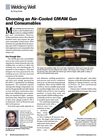

The larger the welding cable, the more heat it dissipates. These guns have the same handle diameter but use different size cables. The top gun has a rating of 250 A at 60-percent duty cycle while the bottom gun with its larger cable yields a rating of 450 A at 60-percent duty cycle.

Threaded consumables use a brass-to-copper connection that increases resistance. They also require a welper to unscrew the tip in the event of a burnback.
