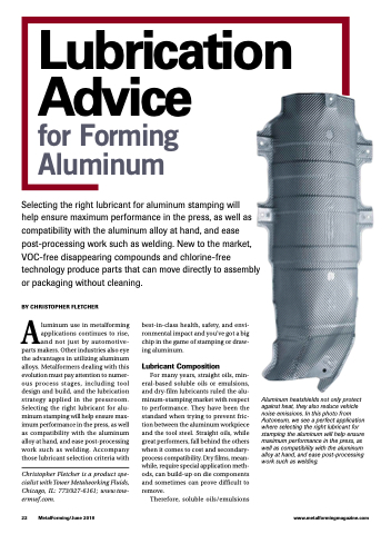

Aluminum heatshields not only protect against heat, they also reduce vehicle noise emissions. In this photo from Autoneum, we see a perfect application where selecting the right lubricant for stamping the aluminum will help ensure maximum performance in the press, as well as compatibility with the aluminum alloy at hand, and ease post-processing work such as welding.
