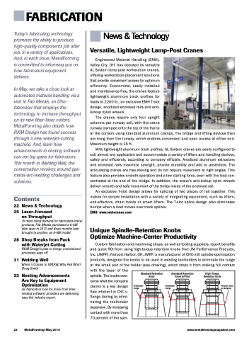

Unique Spindle-Retention Knobs Optimize Machine-Center Productivity
Custom fabrication and machining shops, as well as tooling suppliers, report benefits and quick ROI from using high-torque retention knobs from JM Performance Products, Inc. (JMPP), Fairport Harbor, OH. JMPP, a manufacturer of CNC-mill spindle-optimization products, designed the knobs to be used in existing toolholders to eliminate the bulge at the small end of the holder (see drawing), which stops it from making full contact with the taper of the
spindle. The knobs over-
come what the company
claims is a key design
flaw inherent in CNC v-
flange tooling by elimi-
nating the toolholder
expansion. By increasing
contact with more than
70 percent of the spin-
  Standard Retention Knob
Toolholder bulge
Standard Retention Knob w/Pilot
Toolholder bulge
High-Torque Retention Knob
Thicker wall, no bulging
