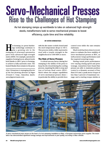

  A servo-mechanical press serves as the heart of a hot-stamping installation at Batz, a European automotive-parts supplier. The instal- lation has demonstrated significant energy savings and improvements in part quality, according to Batz officials.
